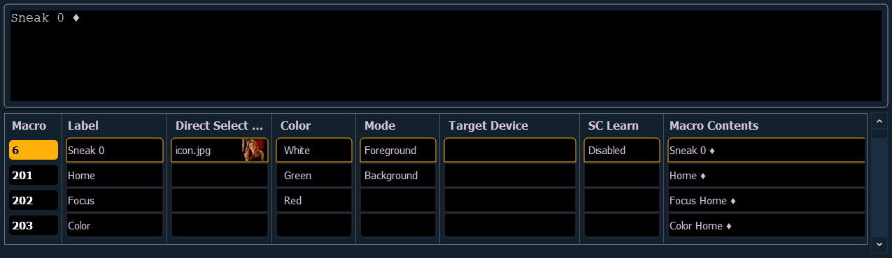

The display is divided horizontally, the top portion displays the macro contents in detail while the bottom portion lists all macros, including the label and contents.

  • {Edit} - when a macro is selected and {Edit} is pressed, you will have entered edit mode for the selected macro. See Editing Macros. Three notable changes to your macro editor display include:
    • a blinking cursor in the macro content detail portion (top) of the display.
    • ”Press [Select] to save or [Escape] to cancel changes” displays above the command line.
